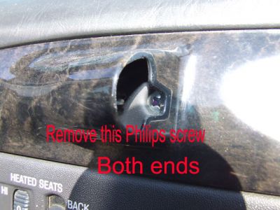

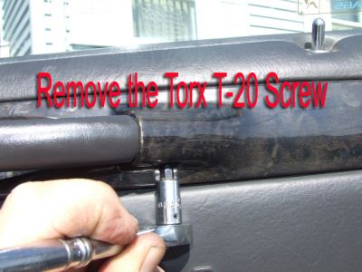

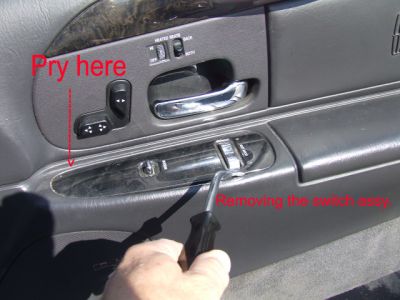

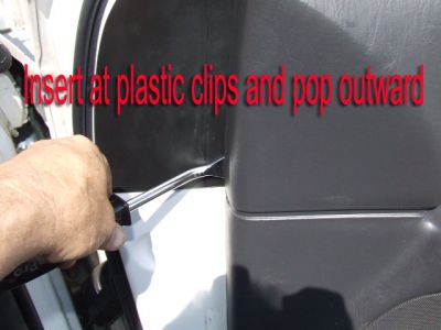

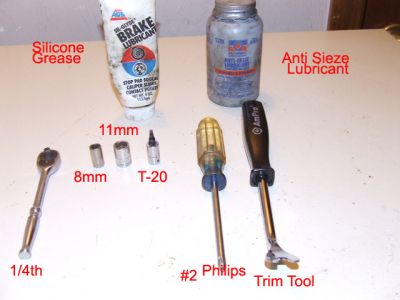

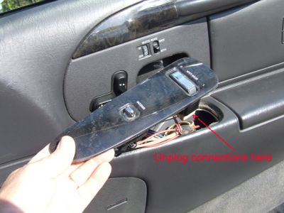

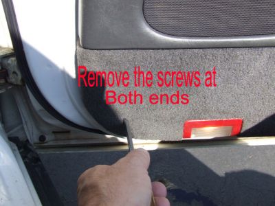

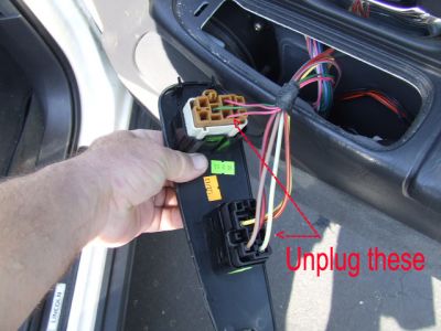

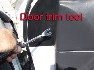

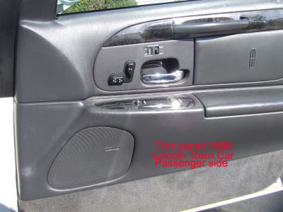

I have all the screws out of the door panel and am not sure where to pry up the ultra cheap squeaky plastic panel cover without wrecking the panel. Is there a trick to this? Thanks.
Jul 11, 2008 at 1:50 AM
MERLIN2021
  • 17,250 POSTS
Use a door trim tool...like this
https://images.2carpros.com/forum/automotive_pictures/62217_Trim_Panel_001_2.jpg
https://images.2carpros.com/forum/automotive_pictures/62217_Trim_Panel_002_3.jpg
https://images.2carpros.com/forum/automotive_pictures/62217_Trim_Panel_003_2.jpg
https://images.2carpros.com/forum/automotive_pictures/62217_Trim_Panel_004_2.jpg
https://images.2carpros.com/forum/automotive_pictures/62217_Trim_Panel_005_2.jpg
https://images.2carpros.com/forum/automotive_pictures/62217_Trim_Panel_007_2.jpg
https://images.2carpros.com/forum/automotive_pictures/62217_Trim_Panel_014_3.jpg
https://images.2carpros.com/forum/automotive_pictures/62217_Trim_Panel_015_2.jpg
https://images.2carpros.com/forum/automotive_pictures/62217_Trim_Panel_018_2.jpg
https://images.2carpros.com/forum/automotive_pictures/62217_Trim_Panel_021_4.jpg
Gently pull panel as yoy remove the clips, to see the two inside by the door handle, I pop them as I go and know the pins out so they don't re-grab the clip...
