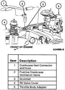

Where is pcv valve on my Marquuis located?
