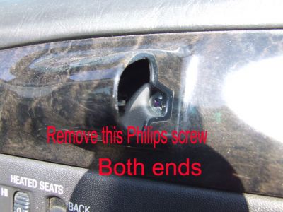

I have to replace the outside passenger side mirror. To do this I have to remove or at least open the inside door panel. Please,please tell me how to do this. Thanks

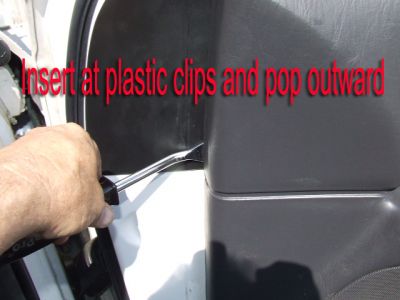

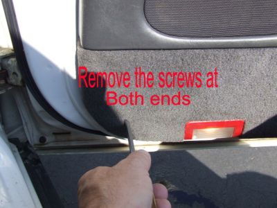

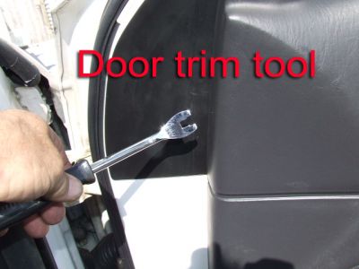

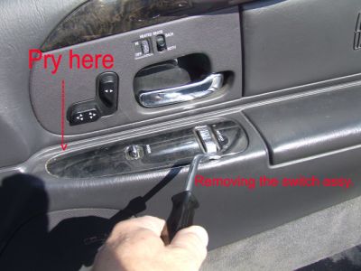

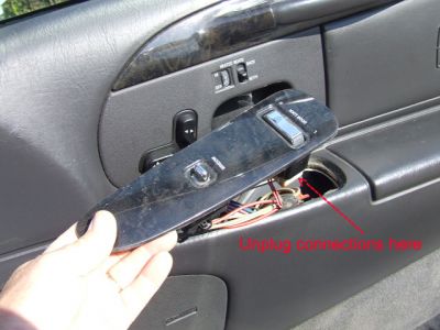

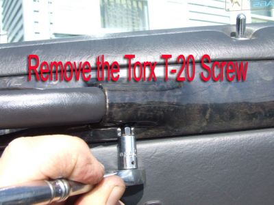

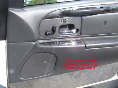

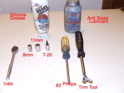

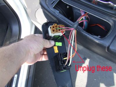

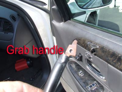

The pictures I posted are from a 98 Town car, virtually identical, so follow these instructions and use these tools!
https://images.2carpros.com/forum/automotive_pictures/62217_Trim_Panel_001_1.jpg
https://images.2carpros.com/forum/automotive_pictures/62217_Trim_Panel_002_2.jpg
https://images.2carpros.com/forum/automotive_pictures/62217_Trim_Panel_003_1.jpg
https://images.2carpros.com/forum/automotive_pictures/62217_Trim_Panel_004_1.jpg
https://images.2carpros.com/forum/automotive_pictures/62217_Trim_Panel_005_1.jpg
https://images.2carpros.com/forum/automotive_pictures/62217_Trim_Panel_018_1.jpg
https://images.2carpros.com/forum/automotive_pictures/62217_Trim_Panel_007_1.jpg
https://images.2carpros.com/forum/automotive_pictures/62217_Trim_Panel_014_2.jpg
https://images.2carpros.com/forum/automotive_pictures/62217_Trim_Panel_015_1.jpg
https://images.2carpros.com/forum/automotive_pictures/62217_Trim_Panel_021_3.jpg
https://images.2carpros.com/forum/automotive_pictures/62217_Trim_Panel_017_1.jpg
With the trim tool get under the plastic rush pins, the door trim holders are plastic and will break, take your time and gently pull out on the panel to find the locations of the clips, there are 2 in near the door handle to watch for!
