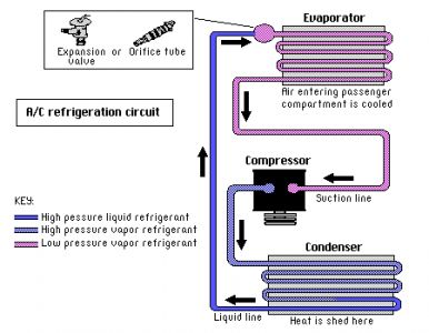

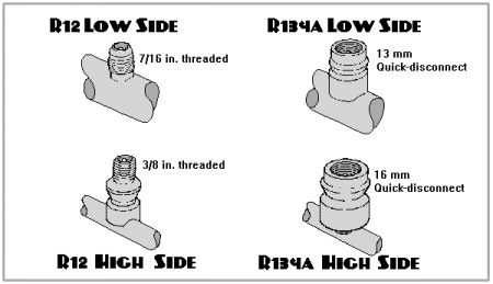

how to recharge a/c
Aug 26, 2009 at 4:47 PM
  • 75,992 POSTS
Find the low side port hook up your freon canister review the label and see below to ID the port/fittings on an R134a system-sorry I don't the exact location of the low/high side fittings-
https://images.2carpros.com/forum/automotive_pictures/12900_ac_service_fittings_16.jpg
https://images.2carpros.com/forum/automotive_pictures/12900_AC_block_diagram_2.jpg
