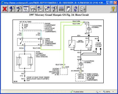

1997 Mercury Marquis HORN DOES NOT WORK
1997 MERCURY MARQUIS
108,000 MILES • 6 CYL • 2WD • AUTOMATIC
BRAILLEMAN
All of a sudden the horn is not working. I have checked the fuses under the dash and they all are okay. I don't know where to go from here.

https://images.2carpros.com/forum/automotive_pictures/416332_1997_grand_marquis_horn_wire_diagram_1.jpg
Go to the horn connector make sure the black wire to the horn has a good ground.Then make sure the dark blue wire to the horn has battery voltage when you press the horn button.If all that's good then you have a bad horn.
