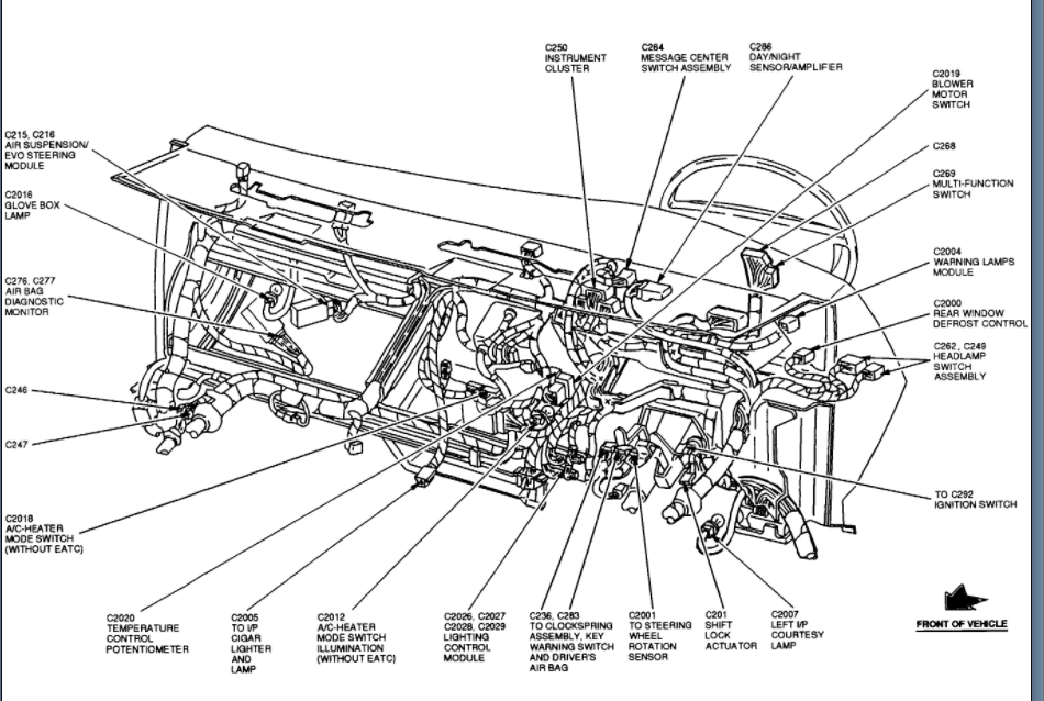

My turn signals and emergency flashers do not work. Where can I find the flasher module?
Jun 11, 2009 at 5:16 AM
You actually do not have a flasher relay. Your flasher is integral to the lighting control module.

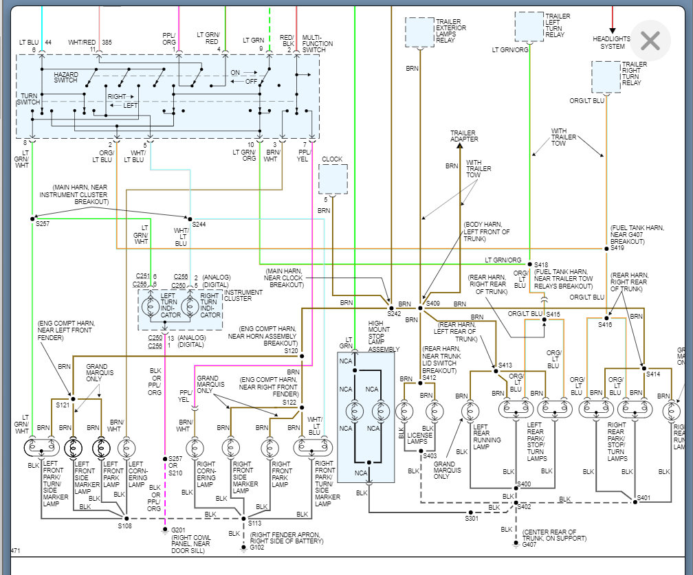

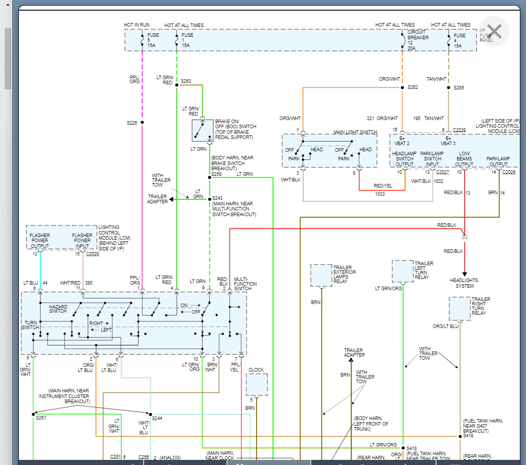

If the flashers are not working then we need to check the output from the control module when the switch is on.
I am attaching the info below on this including the wiring diagrams. Please run through this and let us know what you find.
If you have no voltage from the LCM then we need to replace it.

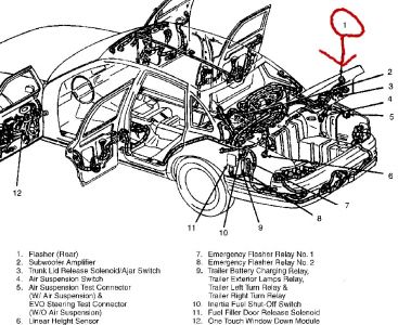

where is the flasher located 1997 grand marquis
Jan 3, 2020 at 7:16 AM (Merged)
SERVICE WRITER
  • 9,123 POSTS
https://images.2carpros.com/forum/automotive_pictures/30961_flasher_1.jpg
Right rear of the trunk.

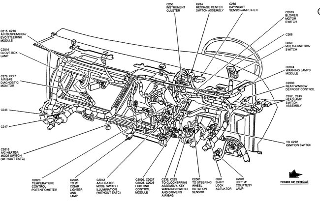

Where Is The Turn Signal Flasher when it is not in the fuse box under the left side of the dash on a 1996 Mercury Grand Marquis?
BLUELIGHTNIN6
  • 16,542 POSTS

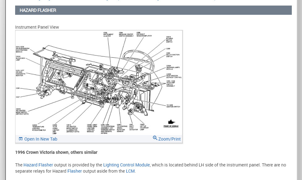

The Turn Signal Flasher output is provided by the Lighting Control Module, which is located behind the LH side of the instrument panel. There are no separate relays for Turn Signal Flasher output aside from the LCM.
