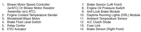

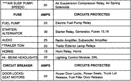

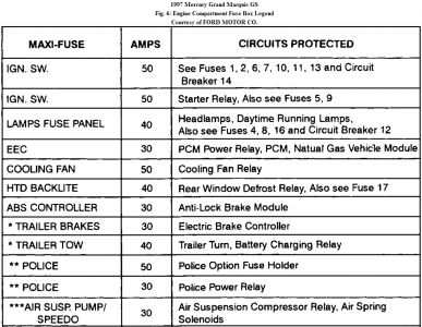

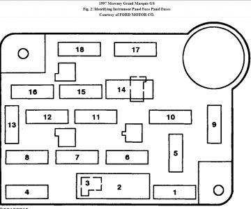

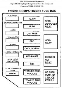

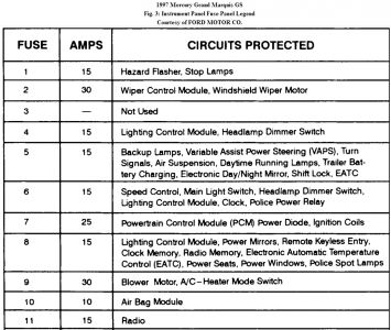

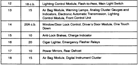

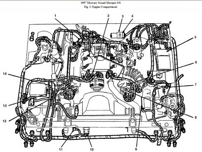

where is the headlamp relay located?
Apr 25, 2010 at 6:29 AM
MERLIN2021
  • 17,250 POSTS
There are several fuses, under the hood relay center, and also inside under the dash fuse box.
