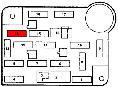

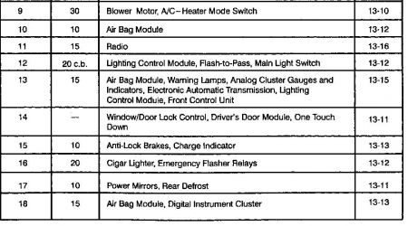

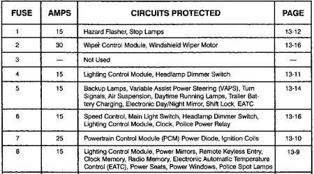

My accesory power source plug on the passenger side quit working. I can't seem to locate a fuse for it. Not mentioned in fuse part of owners manuel.
Sunday, February 22nd, 2009 AT 11:43 AM
ZACKMAN
  • 4,202 POSTS
I believe this is what you are looking for.
https://www.2carpros.com/forum/automotive_pictures/55316_96marquisfuse_1.jpg
https://www.2carpros.com/forum/automotive_pictures/55316_96marquislegend1_2.jpg
https://www.2carpros.com/forum/automotive_pictures/55316_96marquislegend2_1.jpg
