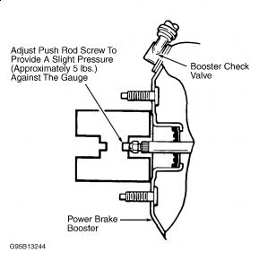

Ok so we bought this car. A 1995 mercury grand marquis and noticed that you had to push the pedal way down before the car would stop. It does no however go all the way to the floor. Under the advice of a shop we had the bakes bled and had the master cylinder replaced with no change. Brakes go down maybe 3/4 of the way to the floor but once there feel pretty tight. If you pump the breaks once or twice it gets tighter and will retain that tightness until you let go . the pedal (which is then imediatly loose again). Any ideas? I hate to keep replacing things that arent bad. Thank you!

check and adjust rear brakes

BRAKE PEDAL HEIGHT 1. Measure distance between center of brake pedal pad and floor. If measurement is not within specification, go to next step. See BRAKE PEDAL HEIGHT SPECIFICATIONS table. 2. Check brake pedal for missing, worn or damaged bushings and/or loose retaining bolts. If components are okay, ensure brake pedal, brake booster and/or master cylinder components are correct for vehicle application. Page 1 of 1 DISC -1995 Mercury Grand Marquis GS Pushrod on the booster that operates the master may be set wrong heres the gauge for checking it.
