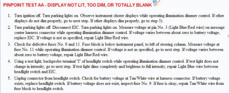

my friend has a 94 mercury grand marquis ls,2 years after they bought the car,the cluster lights went out,they replaced the light switch,and the cluster light worked again,about 3 weeks ago,the battery went bad,they replaced the battery,now the cluster does not light up again,they replaced the light switch again also,and still no digital readings on the cluster,the cars itself runs great,any ideas?

Test this way...
https://images.2carpros.com/forum/automotive_pictures/62217_clustera_1.jpg
