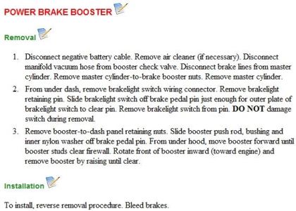

1994 Mercury Marquis brake booster
STEPHIE2
Brakes problem
1994 Mercury Marquis V8 Two Wheel Drive Automatic
How do I remove and replace brake booster?
May 19, 2010 at 9:15 AM
BLUELIGHTNIN6
  • 16,542 POSTS
https://images.2carpros.com/forum/automotive_pictures/261618_Noname_2209.jpg
