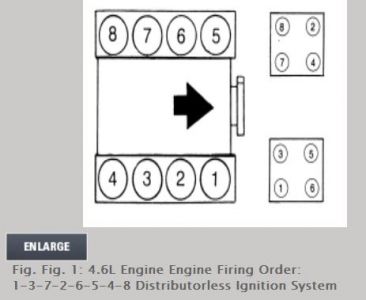

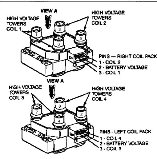

dual coil packs on this car, 2 cyl dead after tune up, by someone else. i think 2 wires may be crossed and i dont have any reference material. narrowed both cylenders to the right side coil pack, cyls 2 and 7 not firing.

https://images.2carpros.com/forum/automotive_pictures/170934_mercury_marquis_1.jpg
Hello, I found the above picture. Check out the images (below).
