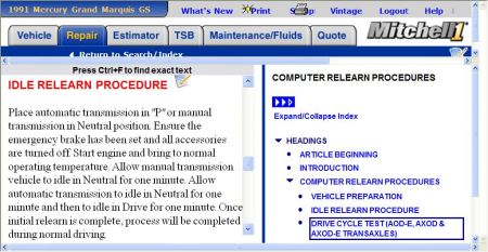

Maybe what's happening here is that the battery was disconnected and computer lose its memory and has to go thru a computer relearning procedures-See below Also do a fuel pressure check making sure the fuel pump is producing the correct fuel pressure.
https://images.2carpros.com/forum/automotive_pictures/12900_iacv_12.jpg
