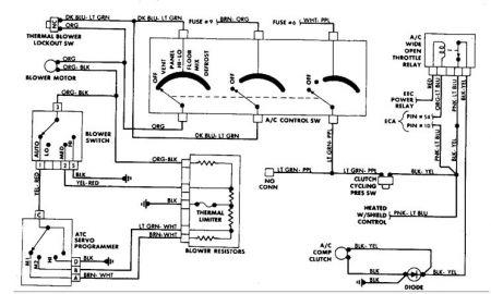

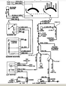

when you turn on the a/c the compressor wont engage. the solenoids open to allow refigerent to circulate, fuses good,. when I run power directly from battery to compressor it engages and it blows cold air so i know its charged. its electrical obviously but my repair manual is not very descriptive, i thing its the a/c cutout relay but dont know where it is any help would be greatly appreciated.

My sources don't give me a location for the ac relay. It should be in the junction block under the hood.
https://images.2carpros.com/forum/automotive_pictures/248092_4_11_20092028421_1.jpg
https://images.2carpros.com/forum/automotive_pictures/248092_4_11_20092033181_1.jpg
I attached both auto and manual diagrams not knowing which one you have.
