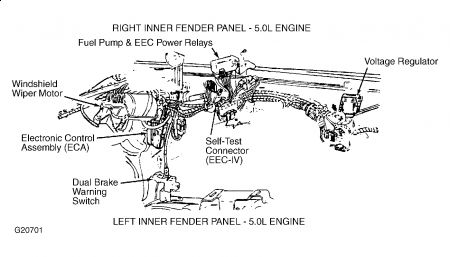

What to check when not getting fuel I suspect the fuel pump or perhaps a relay? Also where are they located?

Fuel pump inside fuel tank the relay see diagram
