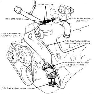

THis is going back awhile. I believe you have a carburator and not fuel injection. If this correct, you will have a mechanical pump. It is located on the driver's side of the engine near the oil filter. Here is a picture:
https://images.2carpros.com/forum/automotive_pictures/249084_pump_4.jpg
To check your pump, you need to do a volume test. The pump should produce 1 pint of fuel in 20 seconds. You may want to check it before replacing it. Here is a picture of the pump:
https://images.2carpros.com/forum/automotive_pictures/249084_pumpp_1.jpg
If your vehicle is fuel injected, let me know. It will have a completely different set up. Let me know. Joe

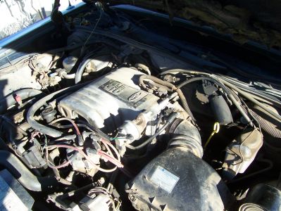

I'm certain it is fuel injected. I have attached a photo for confirmation. My concern is that the fuel pump is in the tank. My folks had a t-bird from around the same time and I thought the pump was in the tank on that model. Don't know if Ford/Lincoln was doing that on a lot of models at the time.
https://images.2carpros.com/forum/automotive_pictures/440294_100_1713_1.jpg
Nov 27, 2009 at 10:56 AM
  • 110,194 POSTS
You are correct. It is fuel injected and I hate to say it but the fuel pump is in the tank. It is electric. I would recommend checking the fuel pump pressure?
