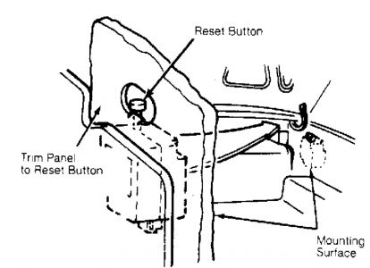

Hello, I have a 1985 Mercury Grand Marquis, I do not have the owners manual for this car any longer and it says to refer to it for the location and reset operation. My car runs and drives A-1, I just happen to be driving on fumes one day, and ran out of gas, I let it sit over night and came back in the morning with gas, put 2 gallons in, jumped in and it wouldnt start, i tried primimg it, the car started everytime i poured a lil gas in the carb body, but cut off as soon as that lil bit ran out, its like its not getting any fuel from the tank. I need help asap. Thanks.

I belive the inertia reset switch is located on the right rear of the trunk.
https://images.2carpros.com/forum/automotive_pictures/30961_inertia_1.jpg

Thanks that did the job, and it was located on the hinge of the truck lid on the drivers side, I held the button down while my girl started the car and it fired right up! Thanks so much!!!
