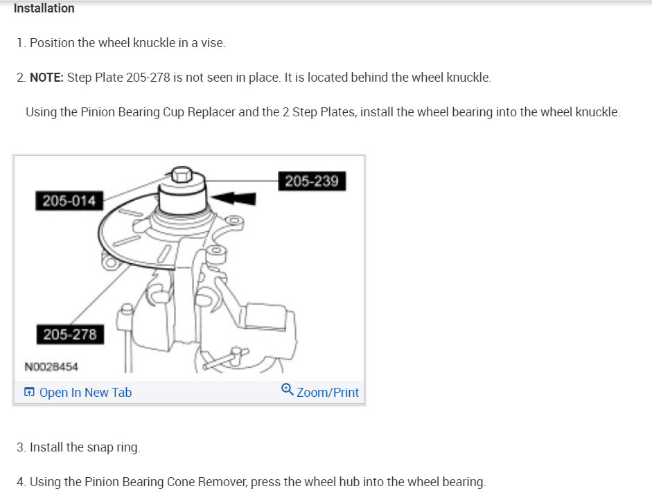

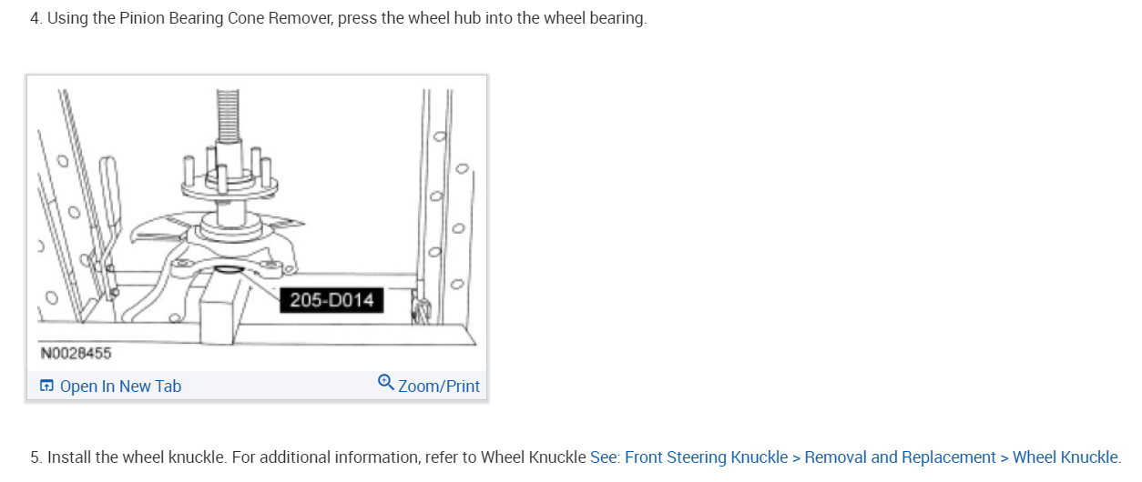

My 2010 Mariner makes loud clicking noises when making turns on hot days only. What could be causing this to happen?
Jul 9, 2010 at 4:08 AM
DOCFIXIT
  • 18,828 POSTS

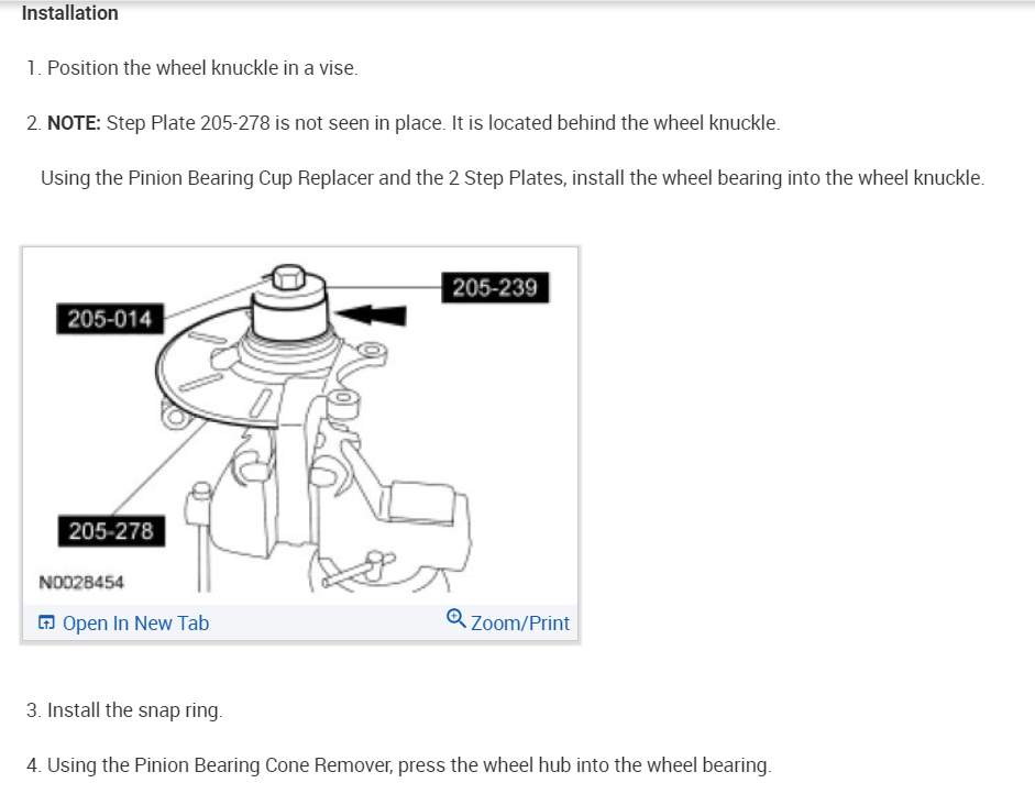

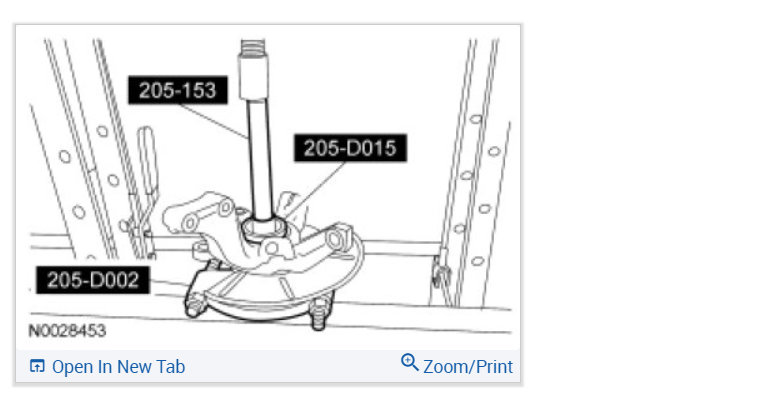

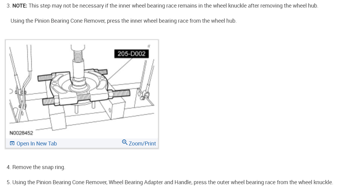

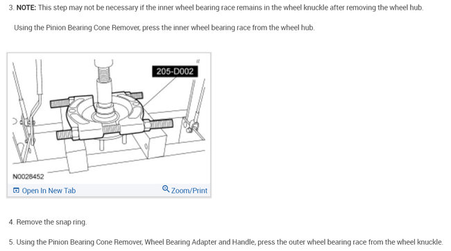

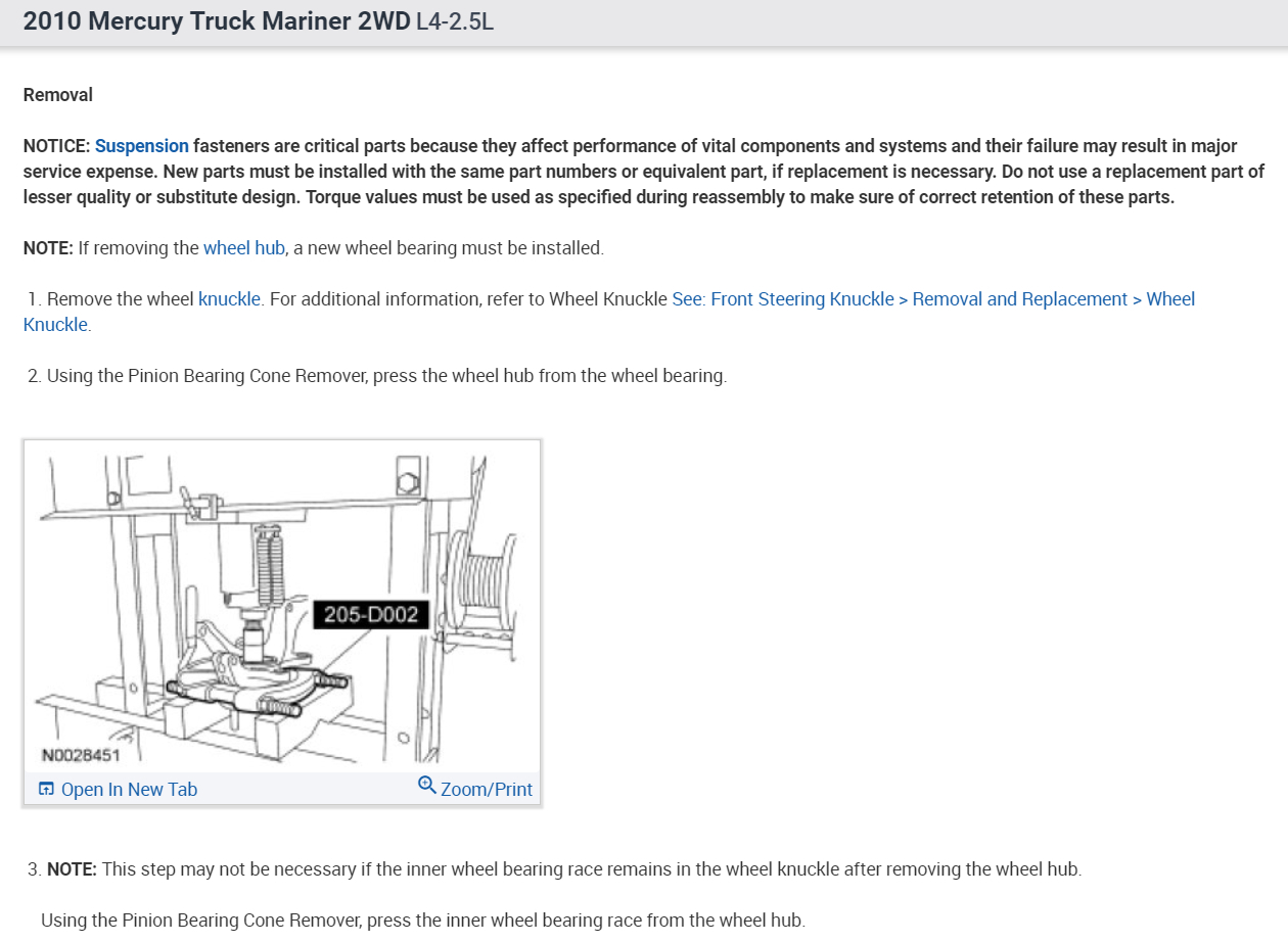

I have seen the front bearing hubs go out on these cars here is a video of a hub bearing being done on a similar car, the process is the same. There are diagrams and instructions below to show you on your car.
https://youtu.be/_FzmmBoa4Tg
Jul 9, 2010 at 7:54 AM
HLACEFIELD
Thank you for this post, I had this problem and had to get the bearing replaced cost me $350.00 all fixed!
