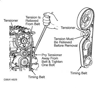

My son is without transportation to and from work and someone is offering to give him a 1985 Mercury Lynx. The catch is that it has a broken timing belt. They have the belt to give us and my son has a great deal of mechanical ability but has never replaced a timing belt. Also, I have read that there is a possibility of engine damage in this car if the belt breaks, which is why they recommend that it be replaced at 60,000 miles. Is there any way of telling if the engine has been damaged before changing the belt? Can you give us some direction or instructions on changing it? Can you provide diagrams that will help? We don't have much but do have a desire to succeed and any help would be greatly appreciated. Thank you!

Ok what I would do is remove the drive belts and stuff and then remove the timing cover and set your timing marks right (refer to pics below). Then put the belt on and then start it (only for a few seconds). If it starts then shut it back off and finish putting it together. If it don't start then do a compression test on it and go from there. I would also check the local library to see if they have a repair manual that you can use so that with that and myself you can put this back to gether and have it runnig.
https://images.2carpros.com/forum/automotive_pictures/249564_Graphic_85.jpg
Releasing the Tensioner
https://images.2carpros.com/forum/automotive_pictures/249564_Graphic1_11.jpg
