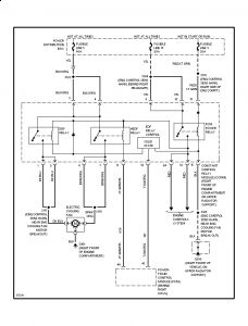

I have a 97 mercury cougar. I have to turn my key half way and let the cooling fan shut off before i can turn it the rest of the way to start it. I had a diagnostic done, and they said it was my pcm. however i declined to get it fixed there and they wouldnt give me the print out of the dx or the codes (if there were any) soooo... how do i check the grounds (where are they) to the pcm to see if that is what the problem is and if it is the pcm could that be what is causing the problem with me starting the car?

Do you have a check engine light on ? lets try and get the codes 1st as it may be the relay / module most local part store can get the codes for free you need an OBDII reader to do so let me know what you have for codes Constant Control Relay Module (CCRM) CCRM interfaces with the PCM to control cooling fan, A/C clutch and fuel pump operation. The CCRM also incorporates electronic engine control power relay to supply power to the EEC-V system

I would for sure seek another opinion as I do not like theirs at all
if they had said its the relay most likely to believe it
but the computer and no codes and every thing else is working
Dont think so (yet)
need more testing
start by Constant Control Relay Module (CCRM)
maybe a good used one to test 1st

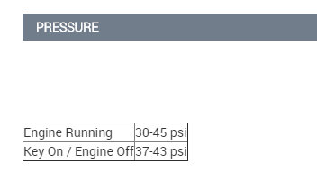

I have to wait for the fuel pump to prime, then it starts right up. If I try to start it before then it just cranks. The colder it is out the longer it takes to prime. I replaced the fuel filter, fuel pump and the fuel pressure regulator, and it still does exactly the same thing. I checked fuel pressure at the rail and it's 30 psi with the regulator and 40 psi when I bypass the regulator. I'm thinking either the pump I bought new (on-line) was no good, or there's an electrical or computer issue. I'm about ready to give up!
Feb 3, 2020 at 1:04 AM
If you measured the pressure with just turning the key on and it was 30 PSI then yes, that is low. It could be the pump but it could also be an injector leaking causing the loss of pressure.
Cycle the key a number of times and then pull the plugs and see if any of them are wet or smell like fuel. If they do then you are leaking fuel in the combustion chamber.
