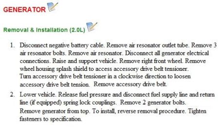

I have a 2002 mercury cougar-4 cyl. My battery light was coming on and then my car died so I took it to a mechanic who said that my alternater was bad. My boyfriend has replaced alternaters in the past so thought he could do it. We have removed every screen and wire we can find but can't get it to drop to replace it. Any tips would be appreciated.

https://images.2carpros.com/forum/automotive_pictures/261618_Noname_2317.jpg
