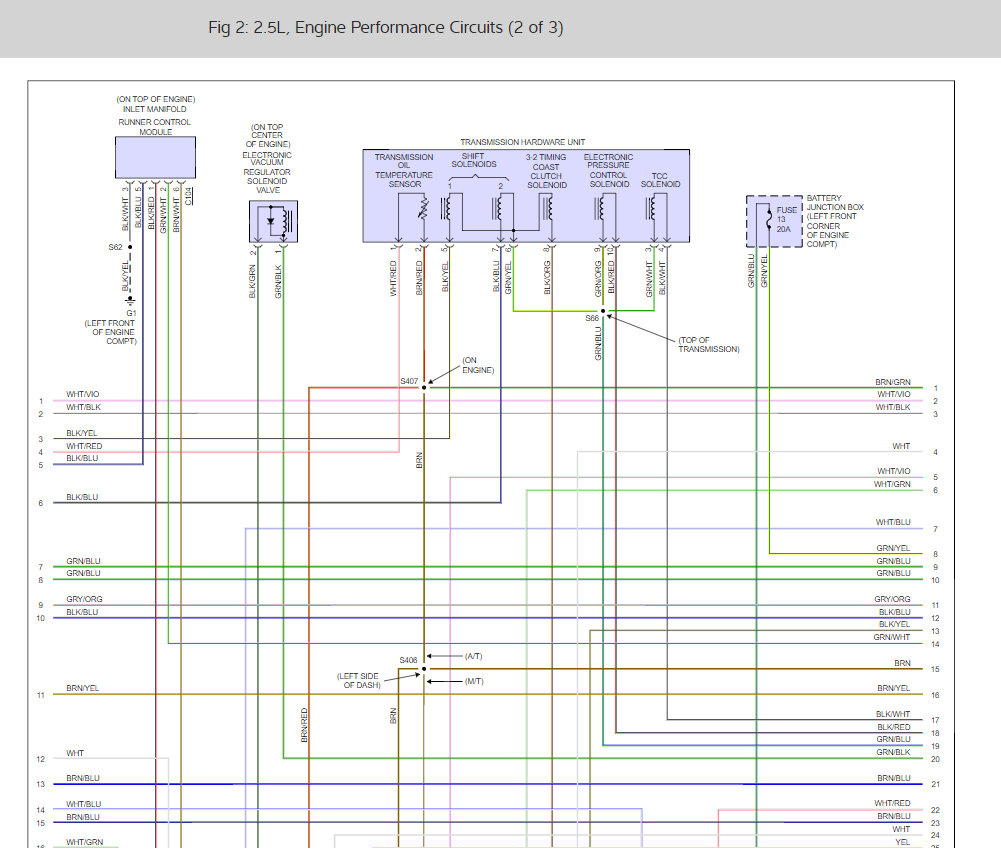

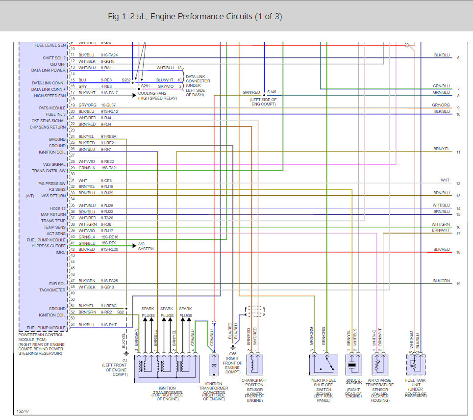

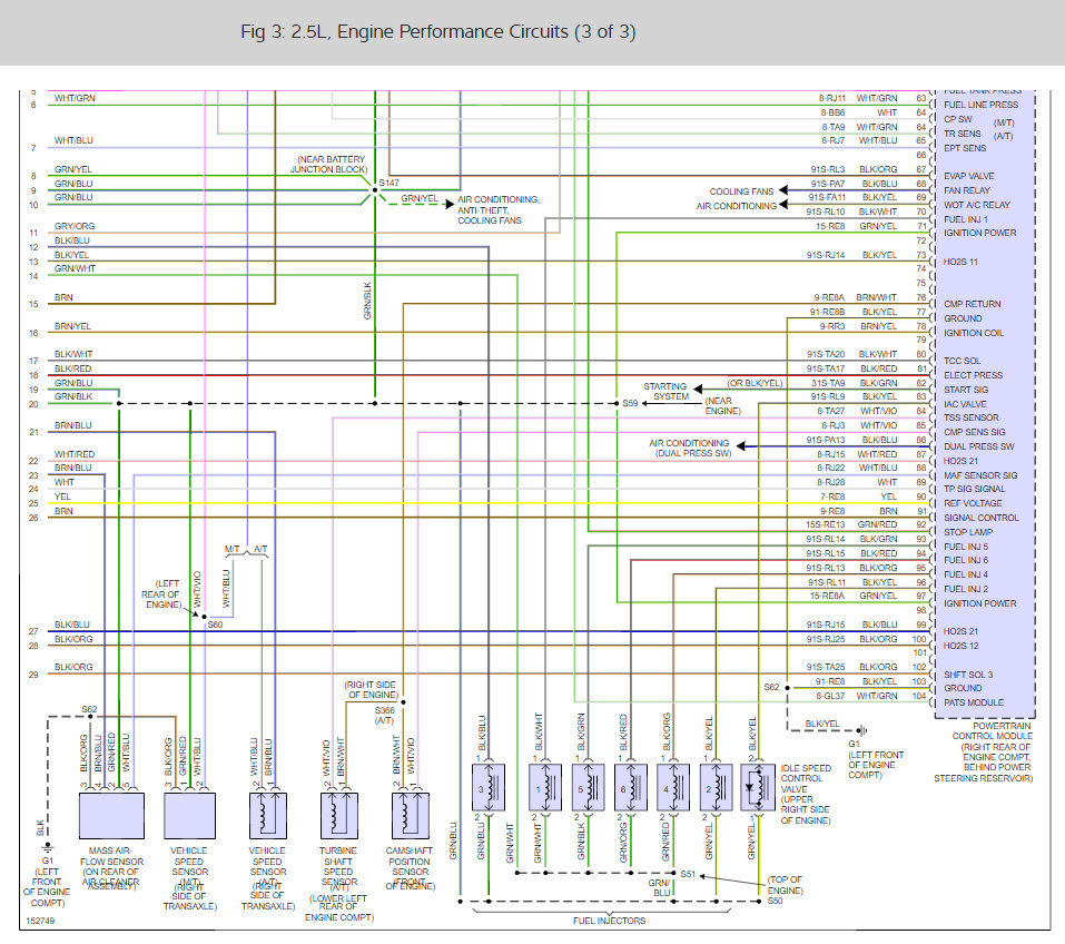

Hello - Check your codes, if you find something and you dont get it fixed and need to get back with us, please make sure you tell us exactly what the code was, number and all. Example, if the code was P0568 O2 Sensor bad. Then make sure you give us all of that. Here is a guide https://www.2carpros.com/articles/checking-a-service-engine-soon-or-check-engine-light-on-or-flashing Now if I understand you correctly you have one, 6 bank coil pack that has plug wires to each plug not individual coils on each plugs? You know you have no spark because you have cranked the car with a plug wire removed and an object in the end of the plug wire and held it near a metal object to see if a bright blue sparked jumped? You dont have a ignition control module on this car. I have attached the ignition parts in the pic below.
https://images.2carpros.com/forum/automotive_pictures/248015_Fig_48_1.jpg

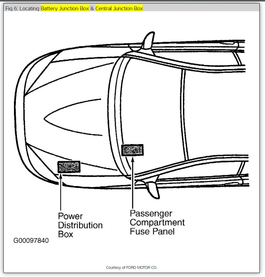

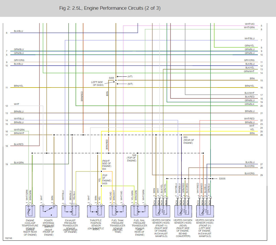

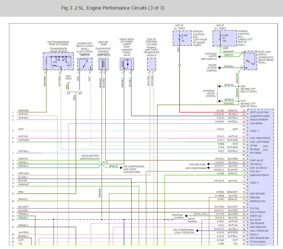

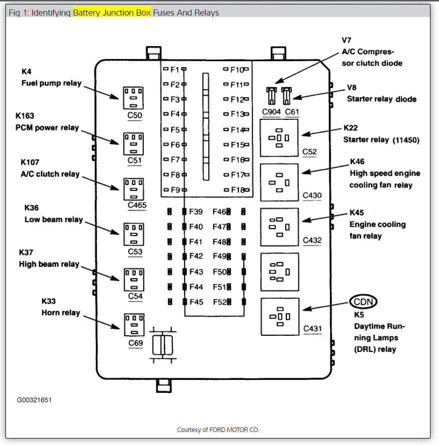

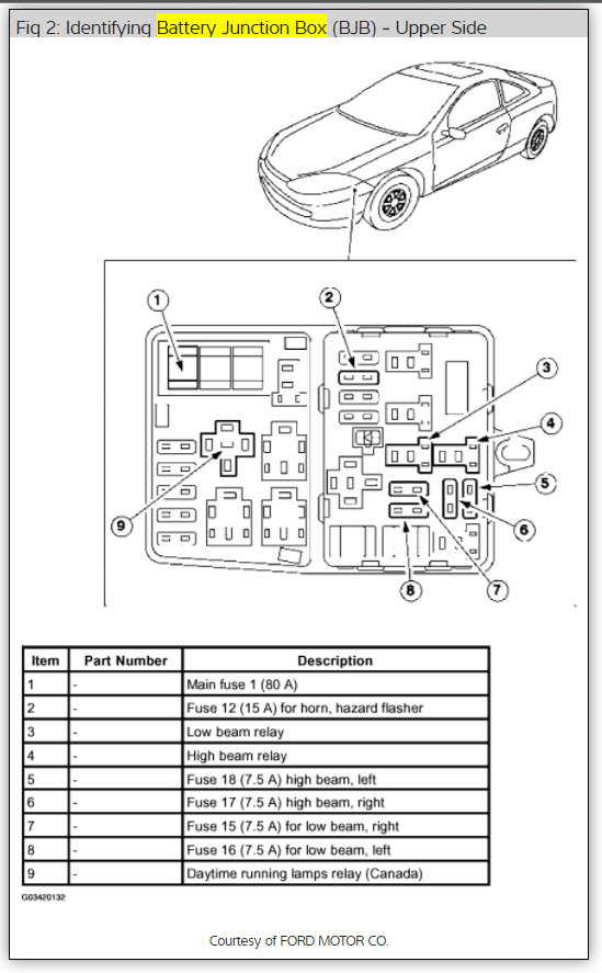

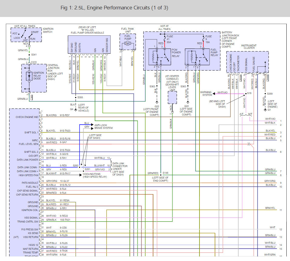

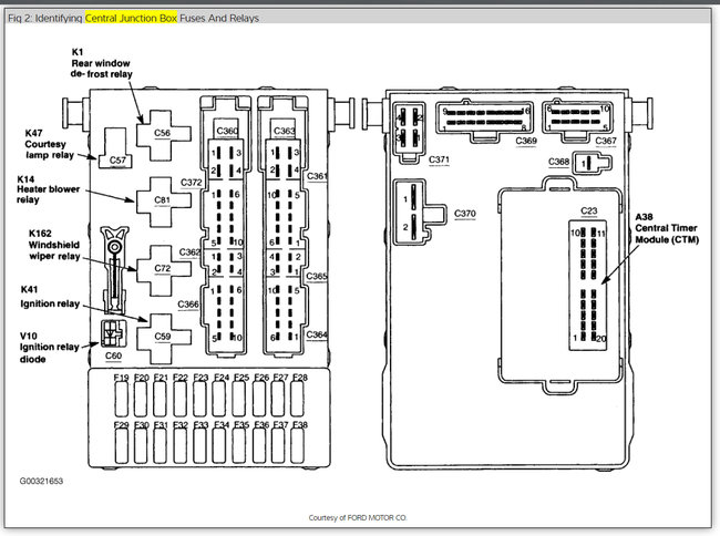

There is however a ECM and an Injection relay that can go out causing the engine to have no spark. Here are some guides and diagrams (below) to help us do some testing. https://www.2carpros.com/articles/how-to-check-an-electrical-relay-and-wiring-control-circuit Please let us know what you find. Cheers

He did not get back to us but I would think the ignition relay would be the cause of this problem.
