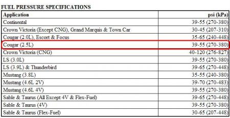

need to know what the fuel pressure should be

https://images.2carpros.com/forum/automotive_pictures/261618_Noname_923.jpg
