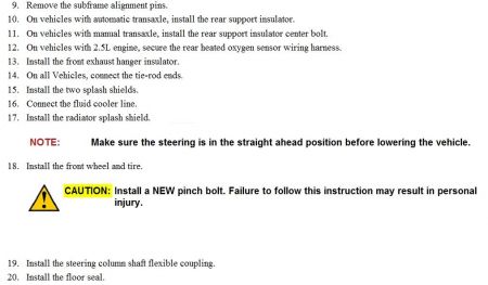

i can't get the old inner tie rod out ? any advice

steering gear must be removed before you can remove tie rod, have you removed it yet?

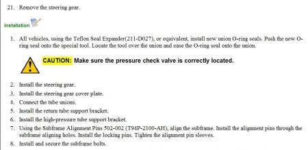

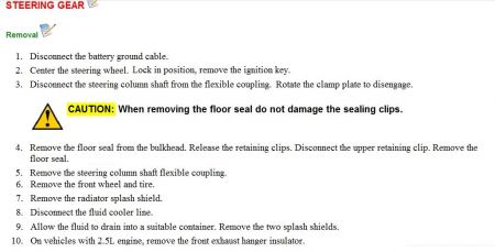

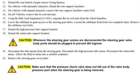

BLUELIGHTNIN6
  • 16,542 POSTS
it is a rather in depth repair so i have posted steps below to help you through
