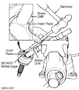

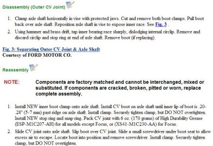

Can anyone give me some details on how to change the passenger cv joint boot on my 2000 cougar please? I like to do things myself, so i'd really appreciate it if someone could help me out.
Jan 8, 2009 at 3:59 PM
BLUELIGHTNIN6
  • 16,542 POSTS
Hello Info you requested is below. Let me know if you need any more assistance.
https://images.2carpros.com/forum/automotive_pictures/261618_Noname_95.jpg
FIGURE 3
https://images.2carpros.com/forum/automotive_pictures/261618_fig_2.jpg
Hope this helps.. Thanks for using 2carpros.com!
