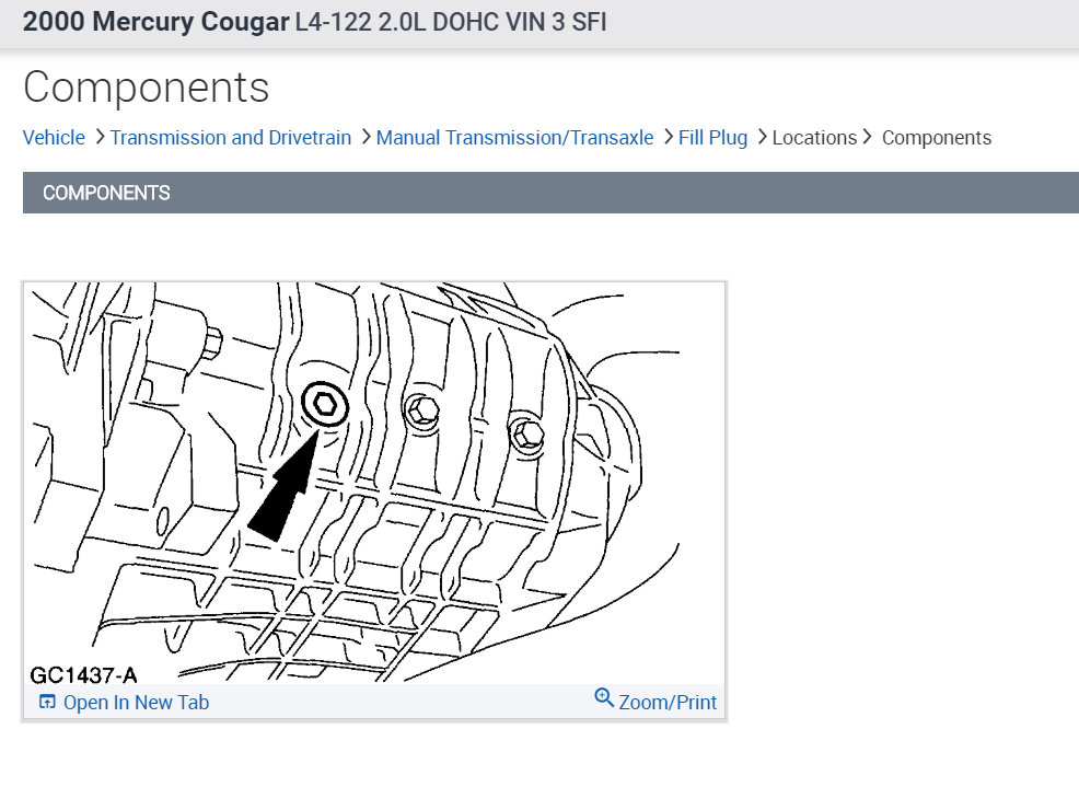

how and where do you put transmission fluid back into the car?

There is a fill plug on the side of the transmission remove the plug and fill with fluid until it runs out. here is the location of the plug in the diagrams below. Check out the diagrams (bBelow). Please let us know if you need anything else to get the problem fixed.
