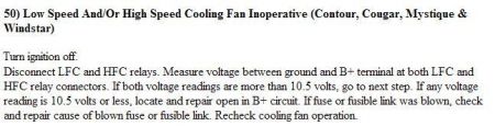

I noticed the other day after I bought a 1999 mercury cougar that it was over heating while i was sitting in the parking lot waiting for my girlfriend at the bank. When I am driving at a steady speed or on the free way it does not over heat, so I am pretty sure it is because the engine fans are not coming on. I then noticed that I never saw or heard them come on, so I came to the conclusion that either the fan motor is out, or a fuse or relay has burned out. I do not have a manual for the car and I have searched the internet and alldata for the location of the relay and fuse and I have found nothing. I need help finding where the fuse or relay is and what the number is for it. What would you recommend that I check first? Im really eager to get these fans running. Thanks for your time and help.

turn your A/C on high. do fan(s) come on now?

I will try it here in a minute, but the car doesnt have ac, the guy before me cut part of the ac lines so it doesnt hold the coolant anymore, would this make a difference. I will let you know if the fans come on here in a minute.

doesn't matter. this will determine if the fan motor is OK or not.

Ok fans did not come on with the AC on full blast what now? Thanks

you will need to follow these steps..
https://images.2carpros.com/forum/automotive_pictures/261618_Noname_917.jpg
