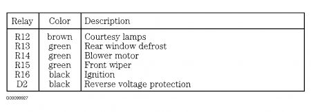

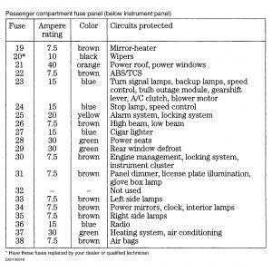

My cigarette lighter does not work. Does anyone have a fuse directory?
Feb 2, 2009 at 7:01 PM
2CARPRO JACK
  • CAR REPAIR CONTRIBUTOR
  • 11,533 POSTS
The fuses should be numbered, heres the legends for the interior fuse block
https://images.2carpros.com/forum/automotive_pictures/1639_cougar1_1.jpg
https://images.2carpros.com/forum/automotive_pictures/1639_cougar2_1.jpg
