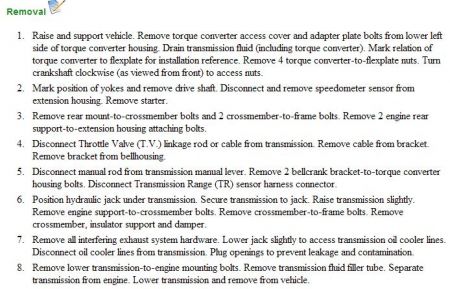

want to know the procedure on how to remove and replace the transmission

https://images.2carpros.com/forum/automotive_pictures/261618_Noname_693.jpg

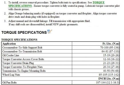

https://images.2carpros.com/forum/automotive_pictures/261618_Noname2_179.jpg

Was attempting tp start this job on my 1997 Cougar. It appears that the gas tank prevents one from removing the drive shaft. Is there a way to remove the shaft without moving the gas tank out of the way?
Jan 17, 2026 at 2:55 AM
  • 55,628 POSTS
Nope! the fuel tank must be removed to remove the driveshaft. Sorry Crappy design.
