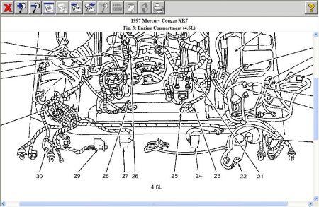

my oil sensor on my dash came on while i was driving. i stoped and pulled out my dipstick to check it and it was still full so i am thinking that the sensor went bad but i can not find it while i am looking for it and do not know if that is even the problem

Engine oil pressure switch see below-Might want to check oil pressure with a mechanical gauge to confirm it-
Jul 28, 2008 at 6:38 AM
  • 75,988 POSTS
Engine oil pressure switch see below item no. 25-Might want to check oil pressure with a mechanical gauge to confirm it-
https://images.2carpros.com/forum/automotive_pictures/12900_oil_3.jpg
