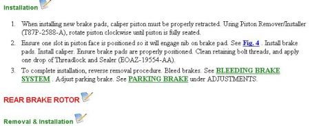

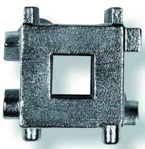

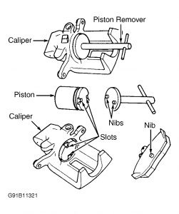

If you can't find that specific tool, your local auto parts will have something similar. Just ask for brake caliper piston tool such as this one by Powerbuilt PN 648410. One of the sides will match the slots of your caliper. Attach it to a 3/8" ratchet and twist..
