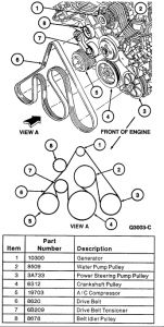

my husband passed away last month, and now my water pump went out. I am having trouble trying to get the tensioner loose so i can get the belt off. can you tell me how to do it? i have not seen one that looks like this before.

Hello, I am sorry to hear about your husband. You and your family are in my prayers. Here is the info you requested. The belt comes off first before the tensionor. I have attached the directions, please feel free to get back with us if you don't understand.
https://images.2carpros.com/forum/automotive_pictures/248015_Belt_1.jpg
BELT ROUTING Refer to the illustration for the drive belt routing. REPLACEMENT Rotate tensioner away from belt using a breaker bar installed in 1/2 inch square hole in tensioner arm. Lift old belt over alternator pulley flange and remove. When installing, position new belt over pulleys. Ensure all V-grooves make proper contact with pulley. Ensure belt is properly installed on each pulley.

i see the square hole, but i'm not sure what you mean by rotating it away from the belt. i've never seen anything quite like this. it looks like a flat plate, with a small pulley above it.

I GOT IT!!!!!!! Woooohoooooo!! the more i read ur answer, the more clear it got. I actually had the old pump out, and the new one in before my dad got here to help me!! boy am i proud of myself. test drove it earlier, put more water in. It's working fine, no leaks or anything!! THANK YOU SOOOOOOO MUCH!!!!!
