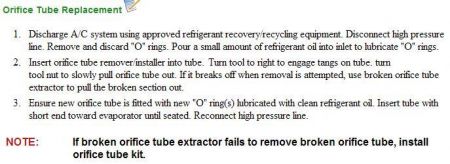

Air Conditioning problem
1995 Mercury Cougar V8 Two Wheel Drive Automatic
Does the whole A/C line have to be replaced to replace the orafice tube?

https://images.2carpros.com/forum/automotive_pictures/261618_Noname_757.jpg
Jul 29, 2009 at 10:24 PM
SOUNDSOFVICTORY
Thank you so much. I have to find out about the tube remover, but this is wonderful. I was told I would have to replace that whole line as well as the condenser, but they had sold me the orafice tube months before by itself so that didn't make sense to me. Thanks again
