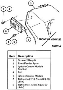

How do I replace an ignition module on a '95 mercury cougar XR7, 4.6L V8?

Service and Repair Notes REMOVAL Disconnect battery ground cable. Disconnect the engine control sensor wiring connector from the Ignition Control Module (ICM) by pressing down on the locking tab where it is stamped PUSH, and remove the connector. Ignition Control Module
https://images.2carpros.com/forum/automotive_pictures/12900_icm_5.jpg
Remove ignition control module and ignition control module bracket from front fender apron (as necessary). Remove two ignition control module retaining screws and remove ignition control module from ignition control module bracket. INSTALLATION Install ignition control module onto ignition control module bracket. Tighten screws to 2.7-3.7 Nm (24-33 in lb) . Install ignition control module and ignition control module bracket onto front fender apron (if removed). Tighten retaining bolt to 4-5.6 Nm (35-50 in lb) . Connect engine control sensor wiring connector to the ignition control module. Connect battery ground cable.
