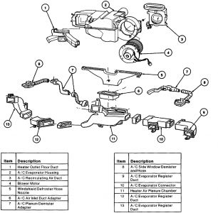

Well. . .. . .. . .. . .I hate to say but I went all through the tech manual I have and I don't have anything other than the pic below on the system. . .. . .. . .which is frustrating. . .. . .. . .

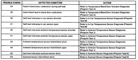

I agree with you in the fact that it is one or the other. . .. . ...but there wasn't a code thrown. . ..the codes I see are like the below. . .. . .. . ...

I wish I could provide more on the HVAC but there just isn't any pic. . .. . .. . ...
Then last resort. . .. . .. . ...and please check back if you would like. . .. . .. . ...the climate control but they really didn't provide much info on this system. . .. . .. . .. . ...
