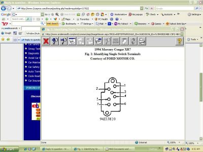

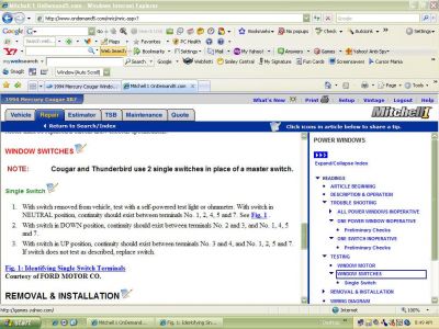

How do I replace a power window motor on my 1994 Mercury Cougar? This is the fifth power window motor replacement in 18 months. I has always been the drivers side. I have also replaced the switch after the first replacement failed in 30-days. The last replacement also included new window tracks. All previous work was don by a dealer, and I decided to do this myself. I am a shade tree mechanic and do all my w=own work on my 1960 Corvette, so I am equipped for both mechanical and body work.
Sep 1, 2007 at 5:19 PM
  • CAR REPAIR CONTRIBUTOR
  • 75,992 POSTS
Check for damaged track or regulator mechanism. Also for open or shorted circuit. www. .com
