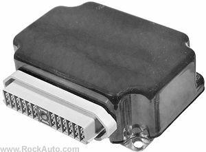

How do I located it and how do I replace it?

Disconnect the negative battery cable-find the PCM behind right kick panel unplug the wiring connector/s to it -be extra care when plugging it back-those tiny pins they bend easily when not inserted properly

Can you show me what the pcm looks like and the kick panel so I am sure I replacing the right part.

The right kick panel is at the passenger side where your right foot be at when sitting down -you will see an access door -the PCM wiil look similar like below
https://www.2carpros.com/forum/automotive_pictures/12900_getimage_4.jpg
