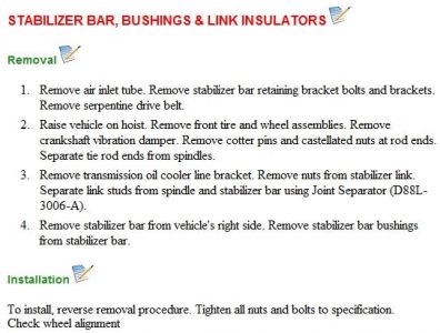

How do you remove the lower joint of the sway bar link on a 93 v6 mercury cougar xr7 ? I was able to remove both nuts, and take a hammer to drive out the the top bolt, but I dont have enough room to get a hammer to the lower joint or pry it out with a pry bar. Is there a special tool, or another way to get the job done? Thank You

https://images.2carpros.com/forum/automotive_pictures/307763_Noname_1.jpg
