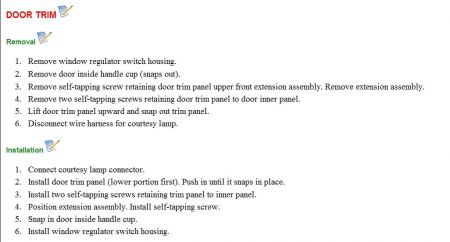

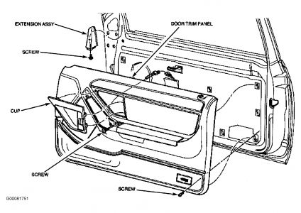

The right sided power window works, but it will not move the window. How do I remove the door panel?

https://images.2carpros.com/forum/automotive_pictures/261618_Noname_2764.jpg
https://images.2carpros.com/forum/automotive_pictures/261618_Graphic_721.jpg
