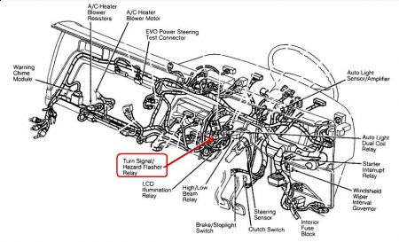

1991 Mercury Cougar need help to find the turn signal relay
1991 MERCURY COUGAR
86,000 MILES • 6 CYL • 2WD • AUTOMATIC
SERGIOAVITIA
I have looked everywhere and asked a lot of people to help but i have had no luck finding the location of the turn signal relay can u help me out??
Dec 29, 2009 at 10:18 PM
BLUELIGHTNIN6
  • 16,542 POSTS
turn signal / hazard flasher relay is located behind the dash, right of the steering column. see pic below..
