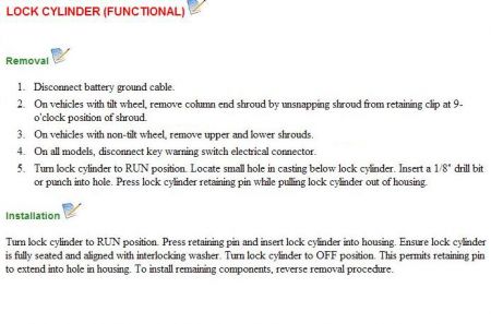

dont know how to change one out

https://images.2carpros.com/forum/automotive_pictures/261618_Noname_1325.jpg
