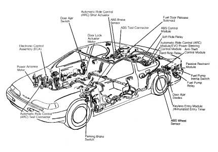

I went over a big bump last week and my car stopped. It acts like it wants to start when I turn the key. It just wont catch. I think it might be an electrical problem. But I don't know. Any ideas?

check the fuel pump inertia switch. It is located on the left rear quarter pannel behind the wheelwell
https://images.2carpros.com/forum/automotive_pictures/1639_mercury_1.jpg
