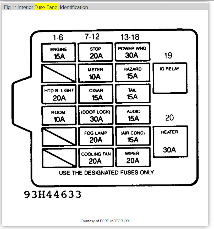

HMAC300
  • 48,601 POSTS
This sounds like an IG relay or ignition switch is heating up and failing. Here is the location of the relay. Also, check for power through the ignition switch when the car stalls.
and
Cheers
Sep 3, 2019 at 5:03 AM (Merged)
CRAZYGANGSTA
  • 0 POST
My problem was the IG relay it was super hot when I touched it.
