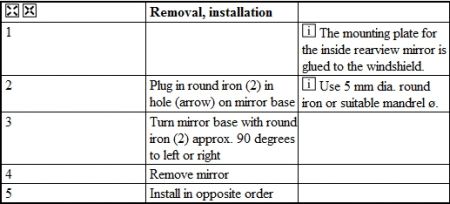

instruction and tools to use to replace the interior rear view mirror

Hello and thanks for donating Below are the replacement steps and tool(s) needed..
