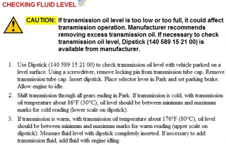

2000 Mercedes Benz SLK230 how to read the special dip stick
2000 MERCEDES BENZ SLK230
FRANK REYES
Transmission problem
2000 Mercedes Benz SLK230 4 cyl Front Wheel Drive Automatic
the dipstick does not tell you if you are low or if you are full, it just has 25 celsius in front, blank in between, and 80 celsius at end of the dipstick. can u tell me the steps in doing a transmission service by using the dipstick. thank you.
Apr 30, 2010 at 8:39 PM
BLUELIGHTNIN6
  • 16,542 POSTS
https://images.2carpros.com/forum/automotive_pictures/261618_Noname_2093.jpg
Apr 30, 2010 at 10:19 PM
