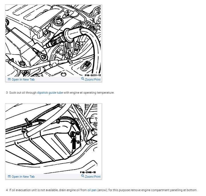

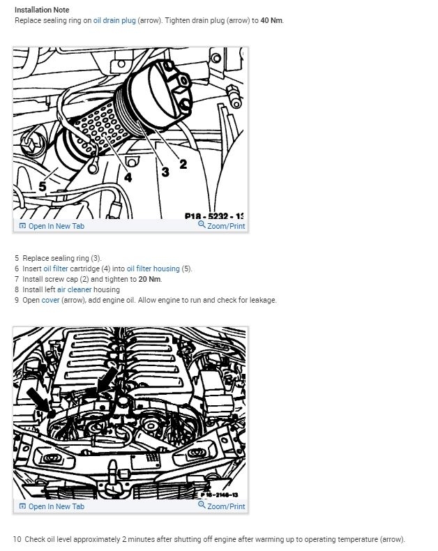

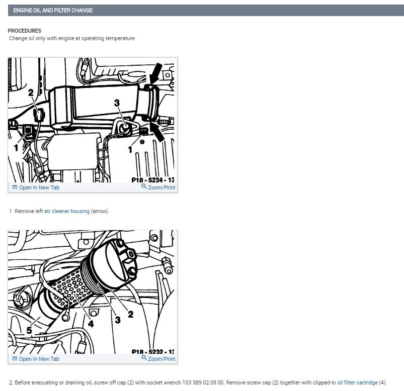

I cannot figure out where the oil filter is and how to replace it.
Oct 16, 2010 at 1:31 PM
BLUELIGHTNIN6
  • 16,542 POSTS
First read the guide below on changing your oil, it will help
https://www.2carpros.com/articles/how-to-change-engine-oil-and-filter
Vehicle specific instructions are attached below

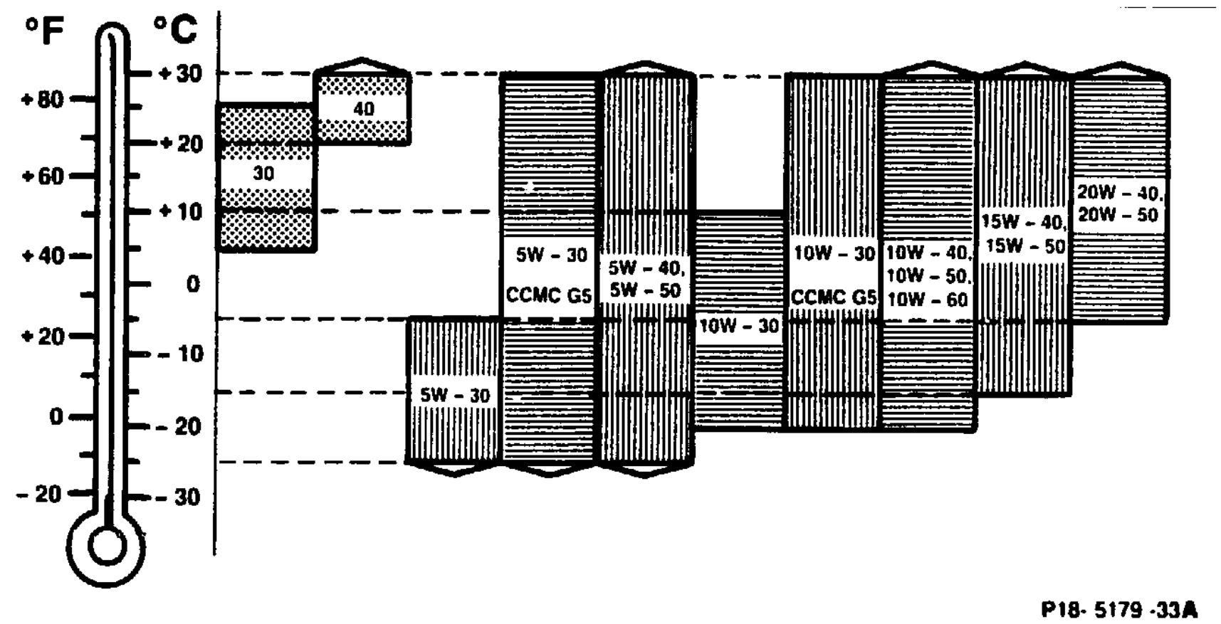

What oil & filter to you suggest for a 1999 Mercedes Benz SL600?
Nov 19, 2018 at 5:32 PM (Merged)
MHPAUTOS
  • 31,937 POSTS
Cars, Wagons, Utilities & Car-type 4-Wheel Drives
MERCEDES-BENZ
SL600 (R129), 5987cm³ V12 DOHC 48V Eng., Auto. (1993-2002)
Crankcase
MOBIL 1 0W-40
or MOBIL SUPER 3000 X2 5W-40
or MOBIL FORMULA X2 5W-40
use genuine filter part# 120 180 00 09
mark (mhpautos)
