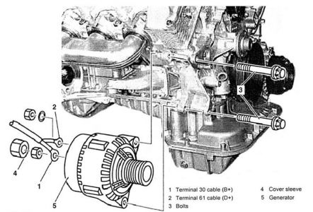

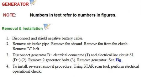

First of all. my car is a 600SL, but it wasn't listed in the model list. I'm looking for step by step instructions on replacing my alternator. Also step by step instuctions on replacing the rear air cells.

https://images.2carpros.com/forum/automotive_pictures/261618_Noname_2301.jpg
https://images.2carpros.com/forum/automotive_pictures/261618_Noname2_758.jpg
