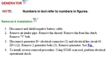

First of all. my car is a 600SL, but it wasn't listed in the model list. I'm looking for step by step instructions on replacing my alternator. Also step by step instuctions on replacing the rear air cells.
