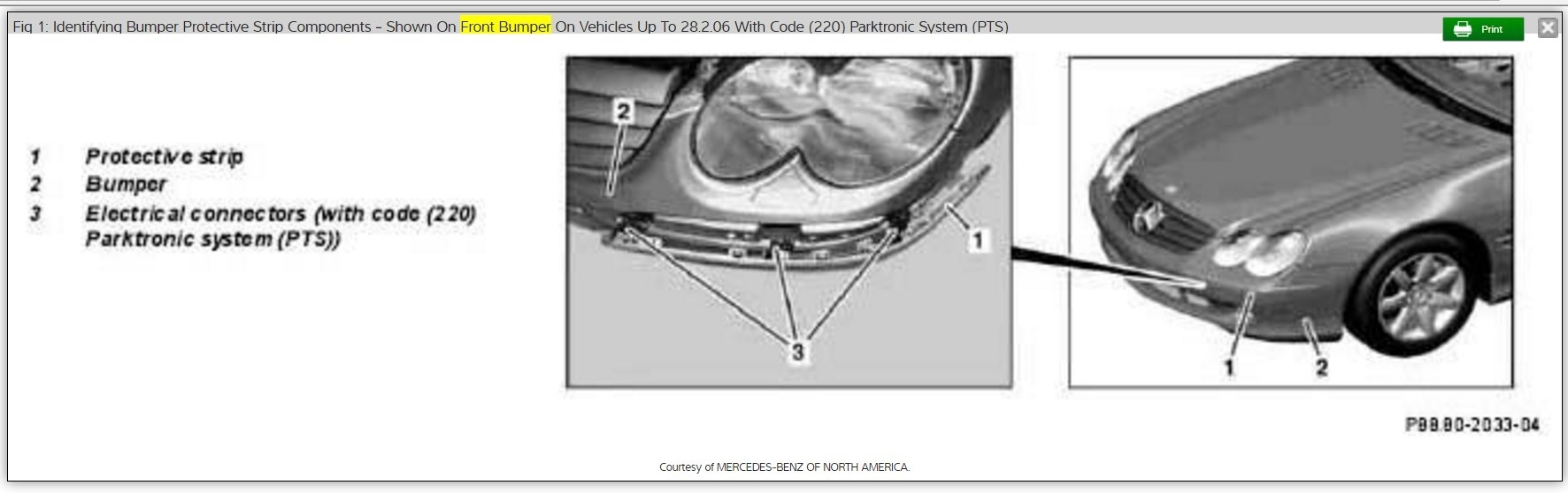

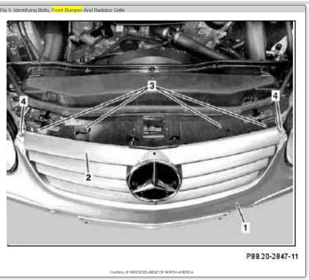

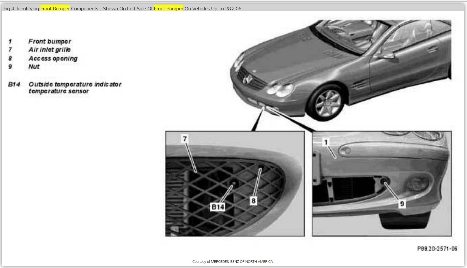

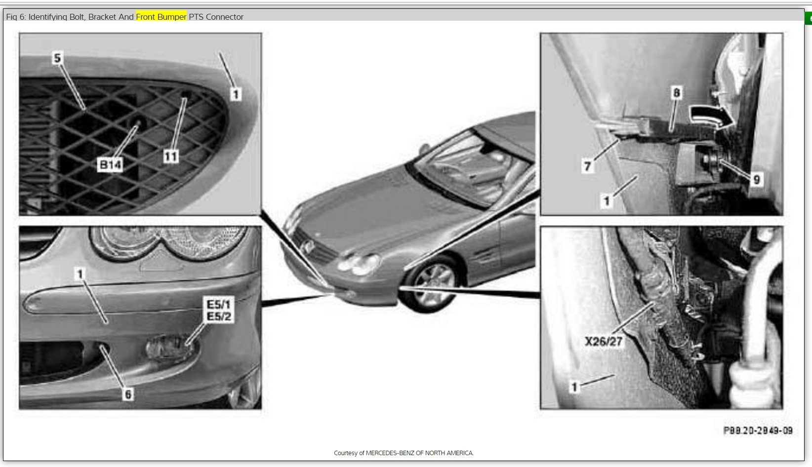

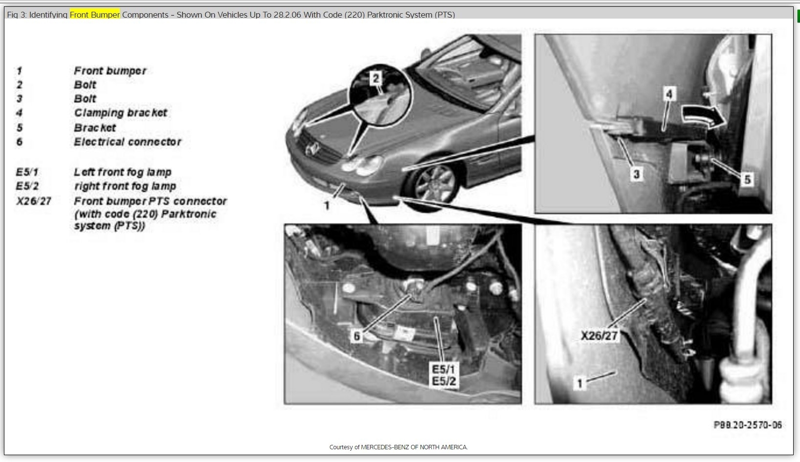

How do I remove the front bumper on my 2003 SL500?
Oct 16, 2010 at 6:39 AM
  • 55,682 POSTS
Hey MORELLO1,
Yes there is alot of hidden out of the way bots you must get to to remove the bumper, Here are some diagrams that will help you remove the front bumper.
