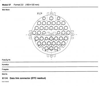

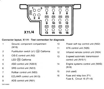

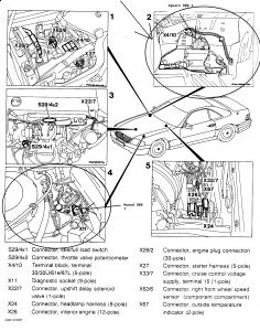

This is a tricky model year because if your vehicle is an early 96 release that was manufactured in 95 you may have ODB 1 diagnostics. Here is a way to check all possible connectors. 1. OBD 1 connectors are located in either the front drivers side of the engine bay under a round twist off cap or in the rear passanger engine compartment under a square cap (see picture I have drawn circle around each connector location) This style will require a MB handheld scanner to read the codes
https://images.2carpros.com/forum/automotive_pictures/294900_129_OBD_1_locations_2.jpg
Square Style Connector
https://images.2carpros.com/forum/automotive_pictures/294900_129_OBD_1_Connector_1.jpg
Round Style Connector
https://images.2carpros.com/forum/automotive_pictures/294900_129_OBD_1_connector2_1.jpg

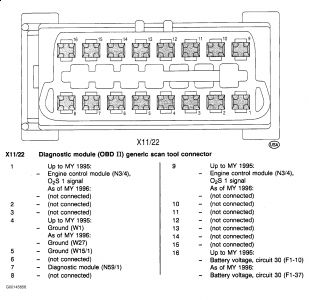

2. Obd 2 connector is under the drivers side dash and will look like this (it is a female connector)
https://images.2carpros.com/forum/automotive_pictures/294900_129_OBD_2_connector_1.jpg
You can use a generic scanner on OBD 2 only connectors.
